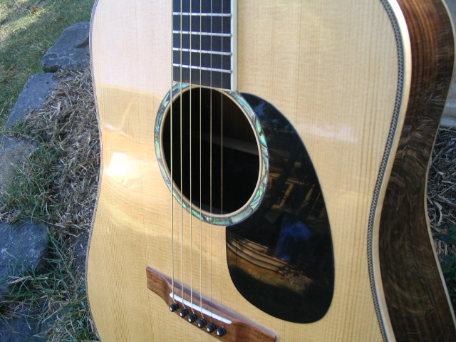

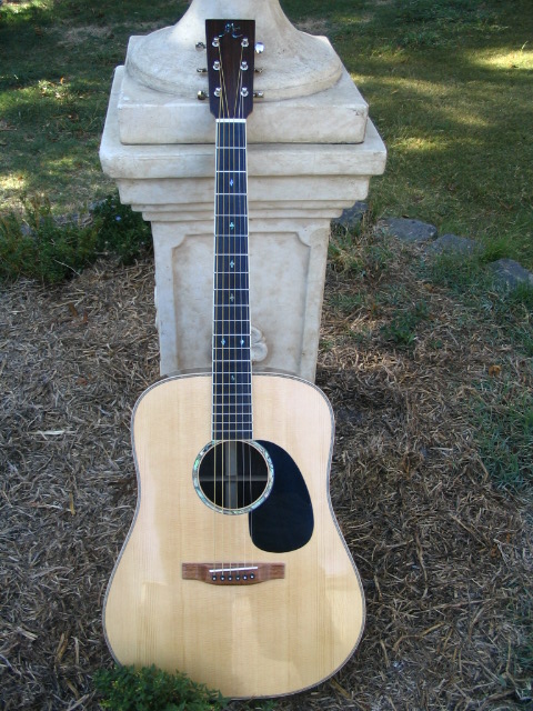

This one went out of the door today.
Dready
EIR back and sides
Sitka top
Goncalo Alves bridge
Maple bindings
Honduras Mahogany neck
Grove Statites
Ubeaut Hard Shellac finish over Z-poxy
The guitar is nicely balanced with terrific projection
and you can really wang into it without it breaking up.
Very happy with this one - basically what a dready should be.

BRAVO ! Bob and Dave . Looks fantastic ! The U-Beaut shellac finish is immaculate. How many coats on this one ?

Very Handsome guitar Bob. It is appointed just the way a dread should be. The rosette turned out great, the finish is immaculate and I want to know more about how you did that, the GA bridge looks great and overall its just very handsome. Nicely done

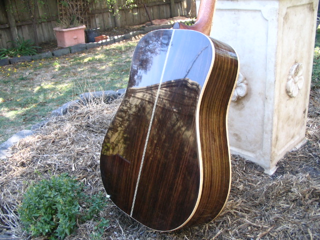

Two coats, eh? This is the second time I heard that about this finish. It is amazing how thick this shellac seems to build, I have never heard of a clear, glossy finish that can be applied, levelled and polished to such a high standard with only 2 coats.   Anyways, I have got to try the stuff out!

Beautiful guitar Bob. It's hard to believe that's only two coats. Gotta try that Ubeaut.

Very nice looking guitar, Bob. Is that a dread shape of your own design? Something looks different about it... maybe it's just the angle of the photo.
Todd Rose
Ithaca, NY

Todd - I took the shape from my 80's D18 so I think it's reasonably standard in shape.
